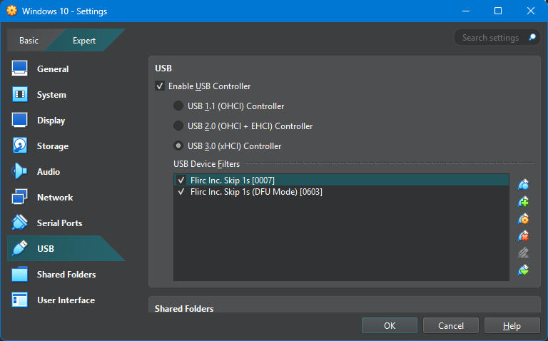

morphx Posted March 24, 2025 Author Report Posted March 24, 2025 Thanks @liambrown, I may give it a try. However, I was able to work around the issue by running Windows 10 on a virtual machine and forwarding the "Flirc Inc. Skip 1s" and "Flirc Inc. Skip 1s (DFU Mode)" device filters from the host (Windows 11) to the client OS (Windows 10) . Quote
