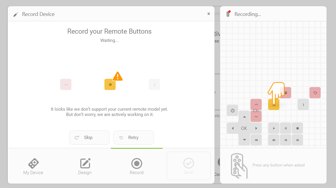

  3. Any chance you can look at adding this remote or something @jason? I've been really patient on this one. I was hoping the learning feature would make it possible but alas no: What does this mean?
