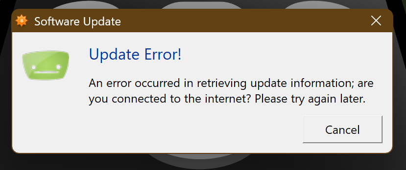

I'm having the same issue. Do we know anything about why this occurs or how to fix it? When I go into the options, it says it's checking for updates but it just hangs here.
