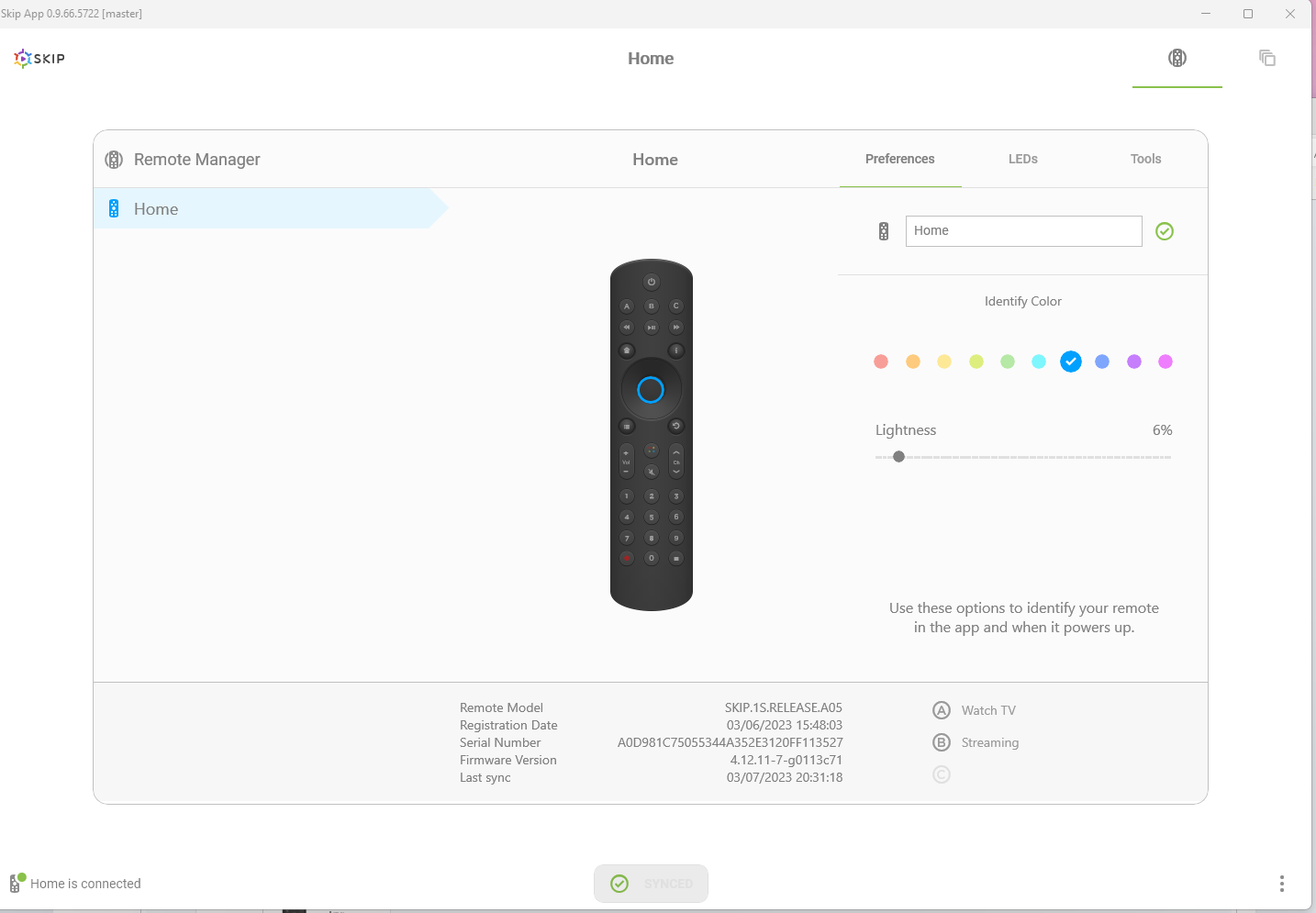

Haff Posted March 7 Report Share Posted March 7 Hi, having weird issues. I have the current firmware (4.12.11-4) I have the latest app version via auto update During setup the controls seem to work with the test. but i am unable to control my devices the LEDs on the skip keep randomly coming on (activities and the central wheel) the central wheel when it comes on is 4 colours, one per segment and when i look at the IR window with my phone camera it is pulsing IR every so often, which sometimes is trying to change channel on my STB I have tried a full reset, and a firmware update but no change in the device Quote Link to comment Share on other sites More sharing options...
