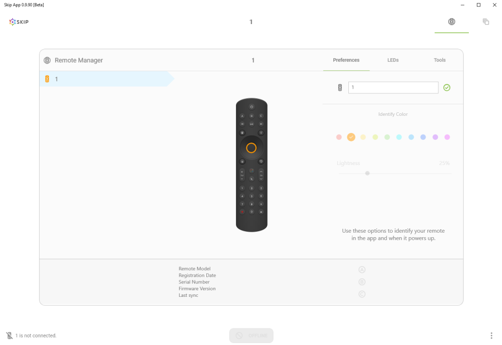

Just received my new 1s.
While the Skip App is up, I connect the cable. The status at the bottom shows "Connecting" for a few seconds, then goes to "Offline". That's all it ever does, and I can't get it to be online in the app.
The remote does appear as connected in skipUpdate-0.9.70, so I was able to upgrade the firmware and downgrade it, but no firmware version changed the connection status.
There are no errors in device manager, and i'm using windows 10.
Solved by Tankonor
  • Solution
It works immediately on Windows 10 22H2 19045.2965
For Flirc devs:
Consider updating your appxmanifest.xml.
Your MinVersion="10.0.17763.0" when realistically it doesn't work with this version of windows.
Consider updating your MinVersion to whichever version of windows this issue doesn't actually occur in. It certainly occurs in 10.0.18362.1256
