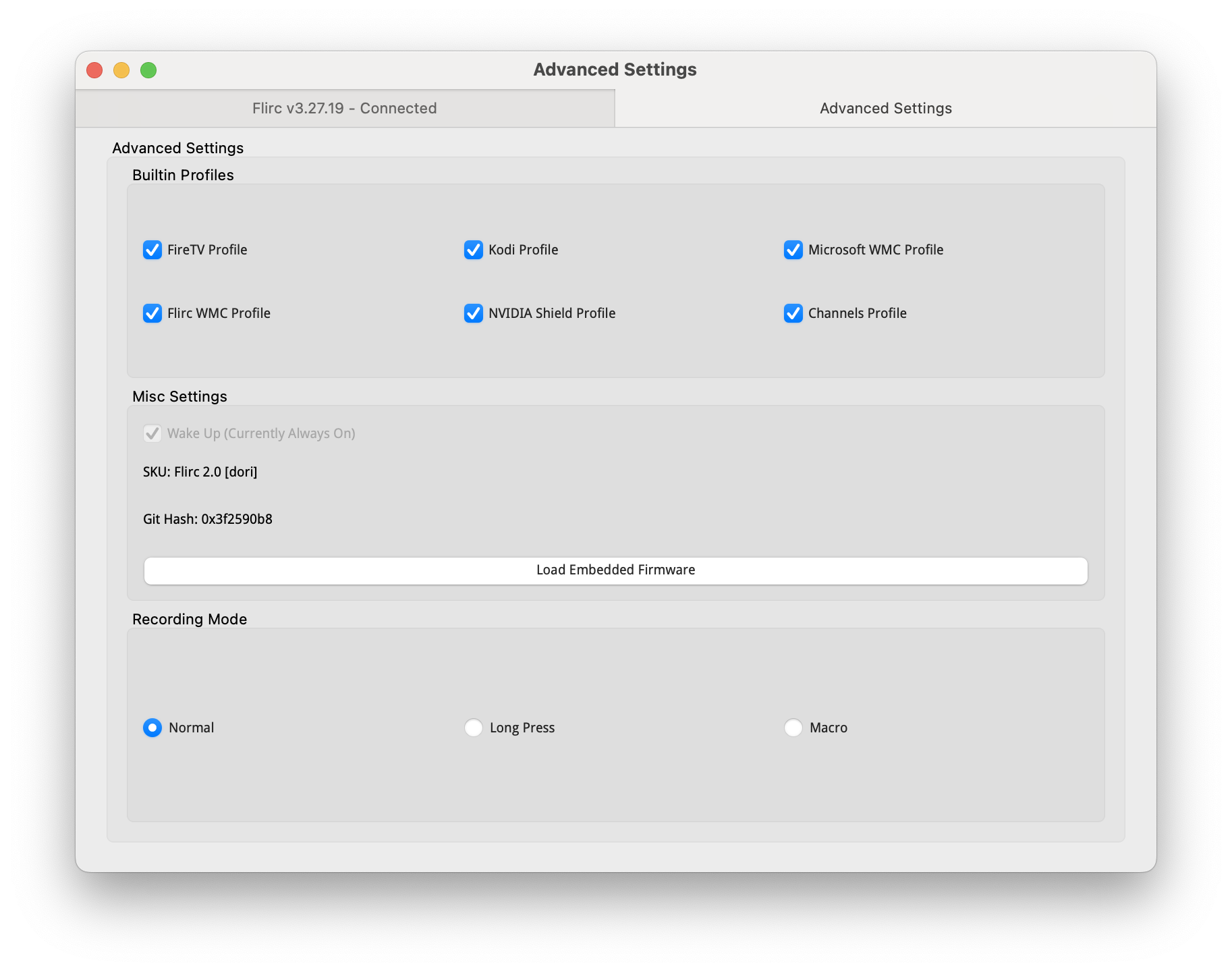

Sorry, what do you mean, " the GUI the buttons light up when pressed but do not record."?
When I connect to the controller and hit play  for example, the play button flashes green on the GUI. When I hit erase and then the button on my remote (flirc skip 1s) the GUI message doesn't change. It hangs on press button to erase.
I have built-in Flirc profiles. Any of the devices by the manufacturer "FLIRC" that you added to skip are pre-programmed and enabled in the Flirc USB. You don't need to do any pairing with those. It is already done.
If you want to disable any of them, open up the Flirc USB's pairing app, then go to File -> Advanced, and disable them.
You are still able to record these keys, but that's on purpose. You are effectively "overwriting" my entry in the built-in profile. If you record and then delete that same entry, you are enabling the built-in entry again. The only way to get it to not respond is by hitting that disable button.
Hope that clears it up.
