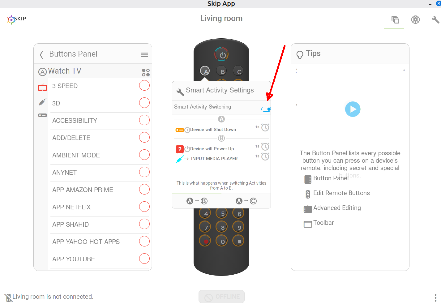

P.Verbrugge Posted March 11 Report Posted March 11 I have an issue with the smart switching. I set up two activities on my remote. Both involve the same Samsung TV. Only the media streamer is different. On activity is under button A and the second one is under B. When I turn on A this works fine. However, when switching to B, the tv is turned off...? I have to push the power on button again, to turn on the tv and start activity B. So I am a little confused on how I should be able to switch from activity. Just pressing A or B when pressing B or A first, does not switch the activity. Quote
StuinUK Posted May 11 Report Posted May 11 Is it actually enabled? A and B will both need enabling. 1 Quote

P.Verbrugge Posted May 14 Author Report Posted May 14 Yes, the button is switched on. I specifically wanted to test the smart switching. How can I export the config? Quote
