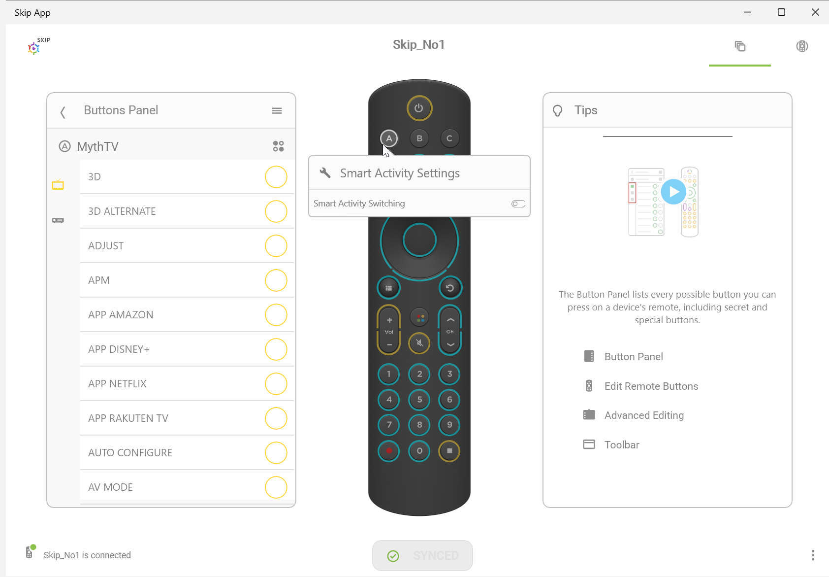

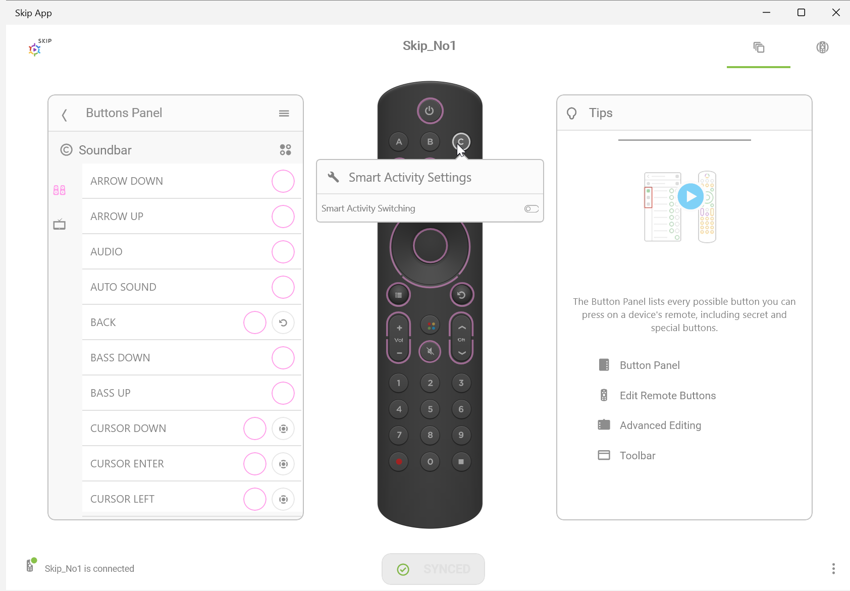

Unable to disable Smart Activity Switching on one of my two Skip 1s remotes
Somewhere along the way my old remote started acting strange (not sure if before or after firmware update).  Anyway I do NOT want "Smart Activity Switching" (is a disqualifier for me) so I made sure it was disabled for activity A+B+C before sync. Unfortunately when switching between A + B + C the remote is still throwing commands.
I have a second (newer) Skip 1s that I have started using & it doesn't seem to have this problem. Skip_No2.skip (attached) is the export from this newer remote.
I have even tried Resetting Skip1's settings and applying the working Skip_No2.skip configuration but I can still see Skip1 throwing extra commands & causing chaos when changing Activities.
Is frustrating... Any ideas?
