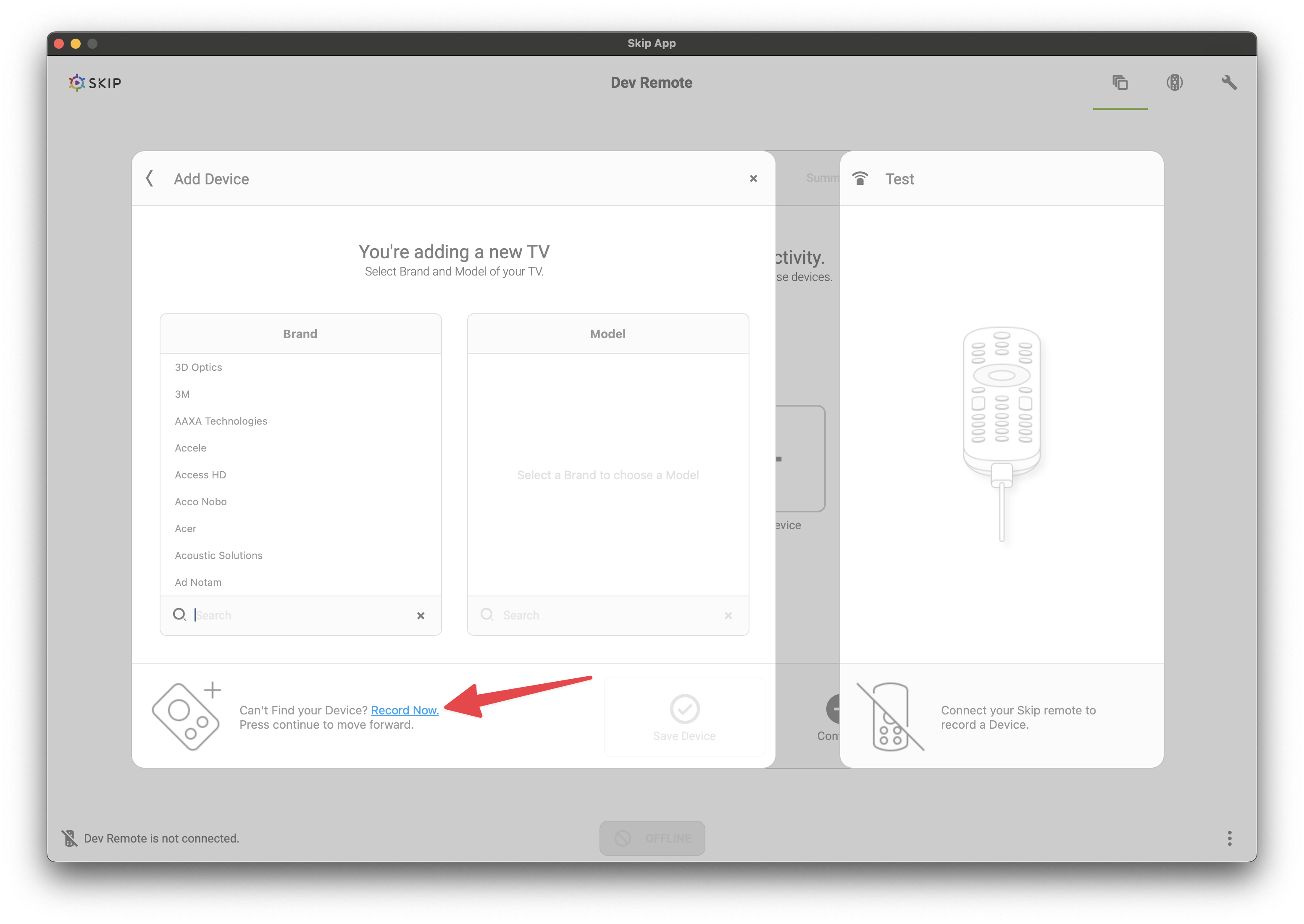

Yes, and you can download the software and setup a remote before having one, so you can play with it. image.png

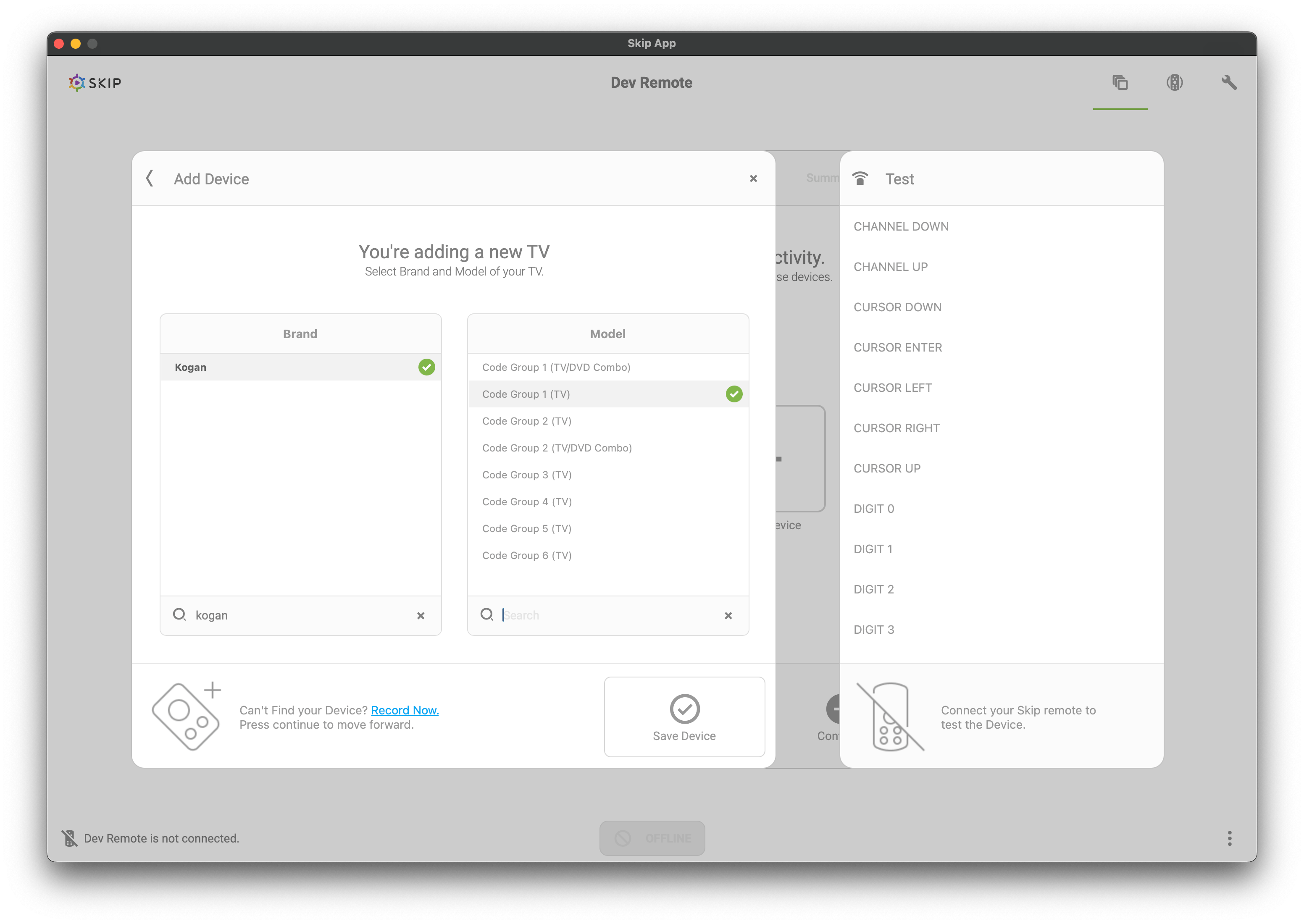

My SKIP arrived today and I have been trying to get it working with my Kogan Q97T. Unfortunately I've had no luck with the listed Kogan models. The only time I was able to get a reaction from the TV was when I selected Code Group 7 (TV), and in that config pressing Volume Down toggled the power, while Power Toggle took me to Live TV. Is there anything more I can try?

Yeah, if you have the original remote, you can try learning it. Let me know if that works.
