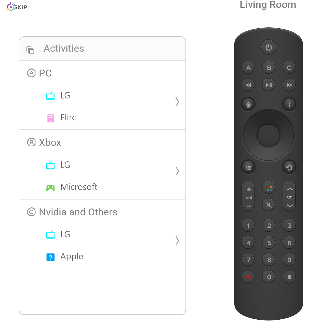

Sure, here is the latest one I've tried. I started off with activity C being flirc-Nvidia. ChatGPT suggested I try other devices thinking the IR would be different. So I've tried a good 8 now.
I'm pretty sure my issue is that the nvidia shield flirc dongle will read the up, down, left, right, enter inputs from my activity A (Kodi on a pc) no matter how I program it's dongle.
In short: The Kodi IR commands associated with activity A are being read as valid inputs on both flirc dongles at the same time. I don't want the nvidia shield dongle to accept the Kodi commands.
On 10/6/2025 at 5:45 PM, jason said:
Ah, okay, I think I know what's going on.
Flirc has these profiles built in. You can disable them. So on the shield, make sure none of the others are enabled. You can find that in file->advanced when plugged in.
Let me know if that does it.
That fixed my issue! Thank you so much!! I really appreciate your help.
