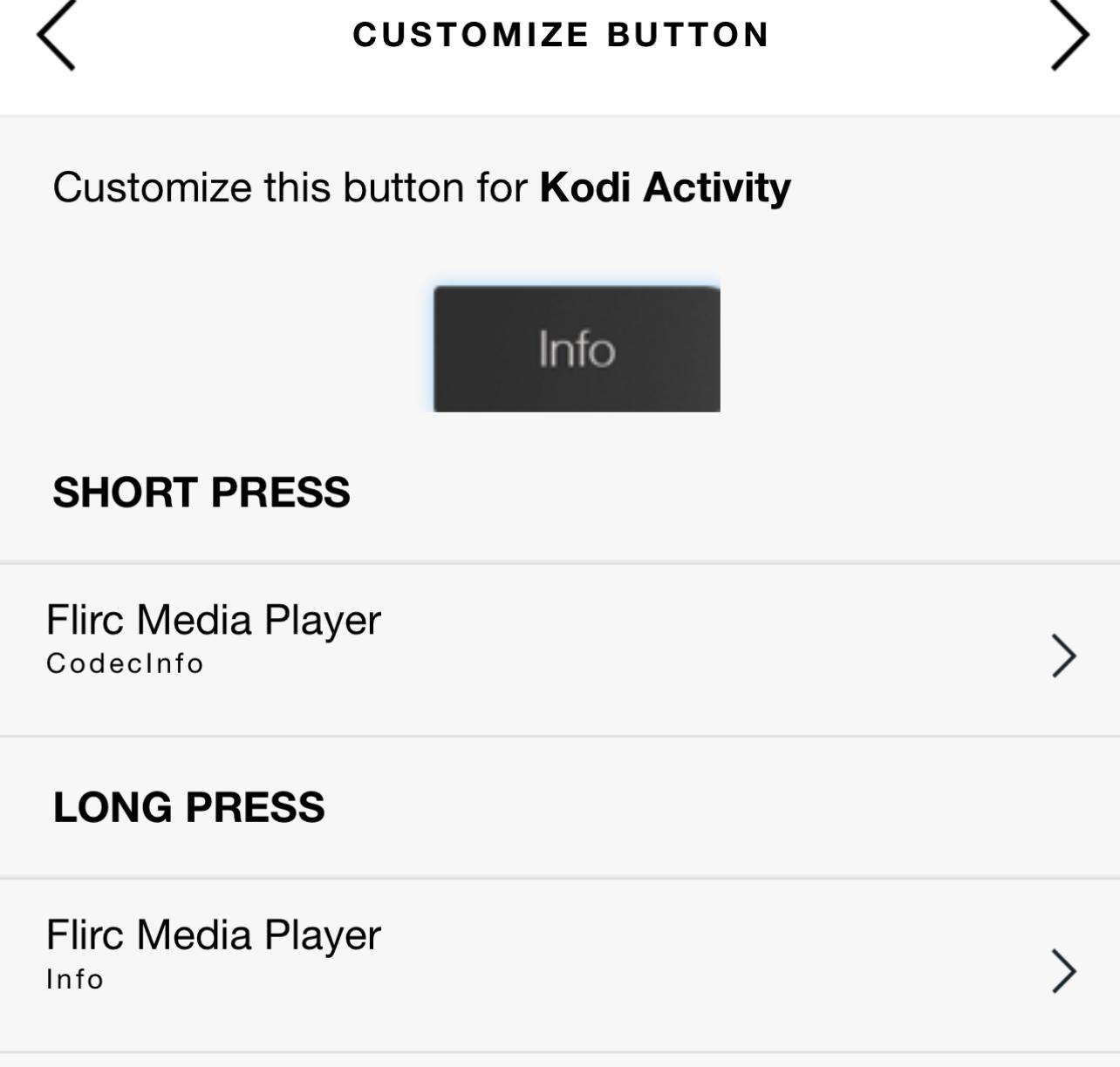

mo.ramzan Posted August 17, 2025 Report Posted August 17, 2025 (edited) Hi, Firc Mac OS App v3.2717 Flirc USB v2 FW v4.10.5 Logitech Harmony Elite with Hub, device added as Flirc Media Player Corelec/Kodi The majority of Flirc commands work automatically. However, I'm having trouble getting the 'CodecInfo' command to work. I have mapped the key to a button, and also on the Harmony touchscreen, but neither does anything. Not sure if this is a bug, or if I should set up the device as XBMC/MCE? Edited August 18, 2025 by mo.ramzan Quote
mo.ramzan Posted August 18, 2025 Author Report Posted August 18, 2025 The device is a Ugoos A6MB+ running CoreElec, and Flirc V2 is plugged into a USB 2.0 slot. The 'CodecInfo' is available in the Flirc profile, but does nothing Quote
