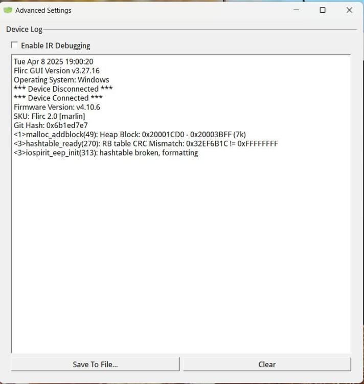

In the Flirc Windows GUI, I reloaded the configuration, and retrieved the Device Log (selected from the File menu).
It says something about broken hashtable.  See below.
Tue Apr 8 2025 19:00:20
Flirc GUI Version v3.27.16
Operating System: Windows
*** Device Disconnected ***
*** Device Connected ***
Firmware Version: v4.10.6
SKU: Flirc 2.0 [marlin]
Git Hash: 0x6b1ed7e7
<1>malloc_addblock(49): Heap Block: 0x20001CD0 - 0x20003BFF (7k)
<3>hashtable_ready(270): RB table CRC Mismatch: 0x32EF6B1C != 0xFFFFFFFF
<3>iospirit_eep_init(313): hashtable broken, formatting
