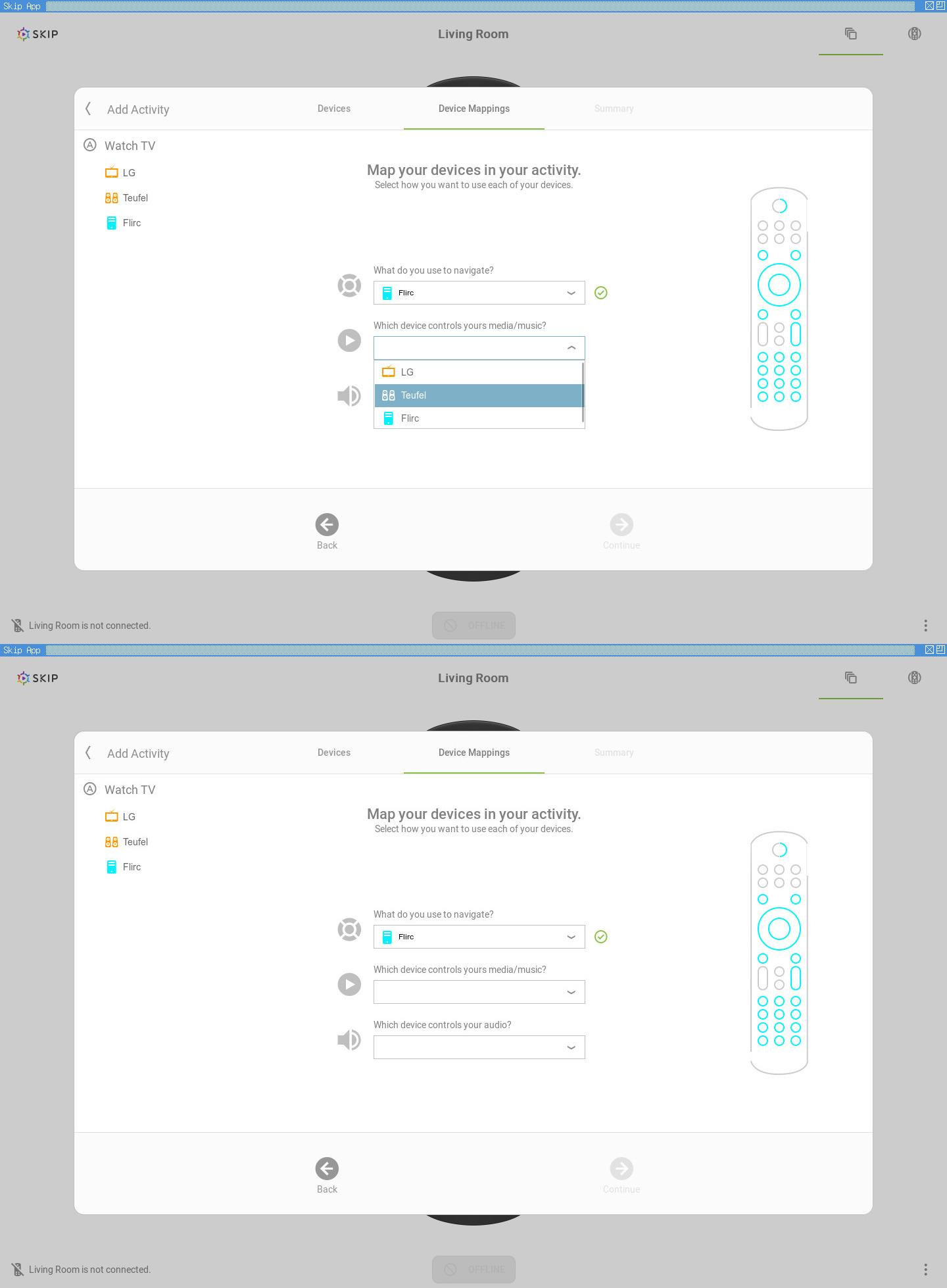

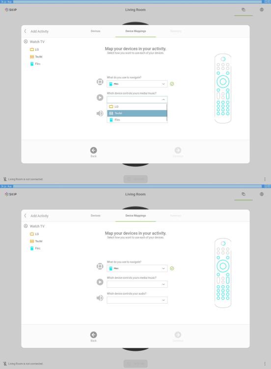

ao-andie Posted February 20 Report Posted February 20 Hi there, an item is not applied when selected in dropdown menu, which is - of course - annoying. :-( Takes by the way up to 5 minutes to start, which probably has to do with internet connection. skip-app_0.9.994+9468_amd64.AppImage uname -r 6.6.74-gentoo Quote
jason Posted February 20 Author Report Posted February 20 12 hours ago, ao-andie said: Hi there, an item is not applied when selected in dropdown menu, which is - of course - annoying. :-( Takes by the way up to 5 minutes to start, which probably has to do with internet connection. skip-app_0.9.994+9468_amd64.AppImage uname -r 6.6.74-gentoo Thanks for reporting this, it should be fixed. Quote

ao-andie Posted February 22 Report Posted February 22 (edited) On 2/20/2025 at 10:12 PM, jason said: Thanks for reporting this, it should be fixed. It turned out that I had to double click on the item. Weird, but works. ;-) Edited February 22 by ao-andie Quote
