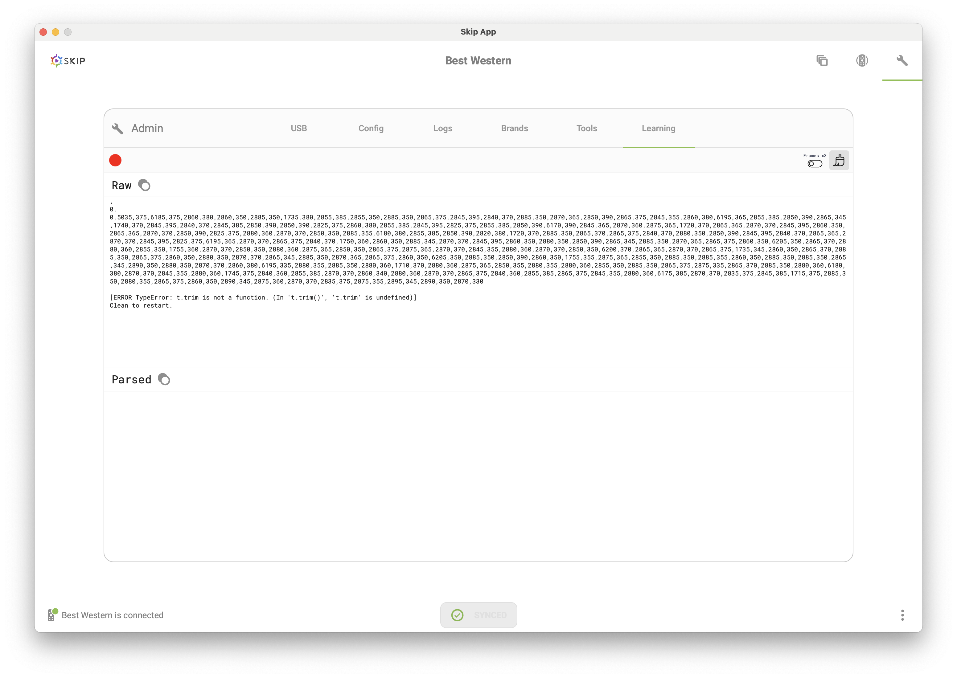

Hello Jason
I have just Updated to the Latest RC Version and I have the same Issue.
I have attached a Screenshot showing the Error.
Thanks in advance
Kevin
Hello Jason
The Issue with not being able to Reach the Servers is now sorted, Thanks for that, however.....
I am able to Learn the First Button of the Remote, however, after I am asked to Press and Hold the Second Button, nothing happens.
I have tried going back and Designing the Remote again but the same Issue occurs.
Any suggestions?
Thanks in advance
Kevin

Hello Jason
I Setup the Remote from Scratch and Imported my Configuration File.
I then tried to Learn a Remote, the First Two Buttons Learned fine, however, when Pressing the Third Button, nothing happens.
I have attached the Logs as requested.
Thanks in advance
Kevin
Skip 1s Logs.zip
  • Kevin Cowans changed the title to Unable to Learn a Remote
Hello @Jason
I Hope you are Well.
Have you made any progress with the Issue of not being able to Learn a Remote?
I am able to Learn the First, and occasionally, the Second Button but after that Nothing.
I am currently using RC 0.9.994.
Thanks in advance
Kevin
I did take a look at the capture and it looks like noise. I'm unable to see any signal.
When you do it, can you make sure the remotes are 'face to face'. I made a mistake with this IR receiver and thought I would caputer the carrier frequency, but it suffers a lot of accuracy. They need to be really close together.
Also, you can enable the admin panel in accessibilities, click the wrench. go to the learning tab, have the remote plugged in, and press and hold a button for me. Just one button. Copy and paste the top window here.
Can you also tell me what remote you are using? Model/pic, would be helpful. Sometimes I just need to buy it if I can't find a code set online.
Here is what that window would look like. There is a 'copy' button next to the word raw.
Hello @Jason
Well, this is weird.
When I follow your Instructions, only One Button produces any Data, pressing other Buttons lights up the Source Remote but no Data is shown.
The Device Model is RTIW387.
The Remote is for the EE TV Pro Box and I have attached an Image of it to this Message.
It is available on the Amazon UK Website  at EE TV Pro Remote
Thanks
Kevin

Looks like the device is only bluetooth, which is why it's not sending anything to learn. I'll check some databases to see if I can find some IR codes. Are you sure the actual device supports IR codes?
