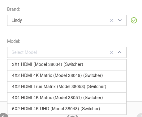

Can record a remote but the remote does not shows up in the list of selectable remotes when configuring the Skip remote.
The remote is a Lindy Model 38249 remote.
As there are already a few Lindy remotes in the database, this is how it looks like in the UI when I try to search for the added Lindy remote.
I suspect that the first "Lindy" in the pulldown menu could be the added remote - not sure, while the second entry probably is the entry for the remotes already in the database.
If I select the first entry, it looks like this.
That is no remotes selectable. As for the second "Lindy" entry I am unable to select that entry. Only the first one is selectable.
But "selectable" is not quite the correct term here as I really can't select anything. In stead I have to type in the name as shown in the pulldown menu and press enter. The pulldown menu is kind of "out of focus/not clickable".
Lastly here is how it looks like when I remove the recorded remote.
Again I can't really select any of the entries in the "model" pulldown menu. I have to type in the name of the entry which I want.
