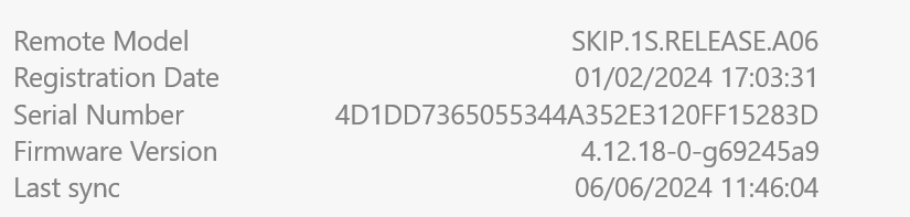

I was thinking I needed to upgrade in order to do learning - to create some needed keys for the LG tv but when I went to check my fw version this is what I see at the bottom of the skip app.
here's my firmware version - does this make sense?
the reason I ask is that the latest beta I can find a reference to in the forum is 4.12.12. So how come I have this later version showing in my skip app.
Edited by mooncaptain
