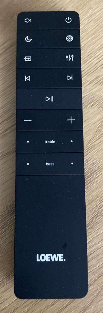

April 14, 20242 yr Author comment_35483 Why you say "second button" ? I just press and hold volume up This is the remote pic : Report
April 15, 20242 yr comment_35491 No, something went wrong. You were pressing the button, and it looked fine, and then all of a sudden the length of numbers reported increased. If I'm to believe the first press, than I see nothing wrong with the code. Can you try to re-learn again? Once done, save and post your configuration file. Report
